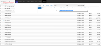

I have created a share URBACKUP on the QNAP. This is the backup directory there is also (see screenshot) a copy of the database and server settings stored.
But this is not the "working directory"
How can I find this via SSH?
The installation folder with all settings.
I guess the solution will be to copy the data away from the installation folder.
