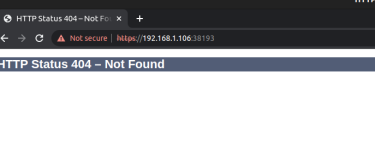

Good morning,
I come from qnapclub but I see that there are no more updates for unifi.
I installed the myqnap.org version yesterday
but I always get an error
HTTP Status 404 – Not Found
when I try to open mango db with the open button nothing happens
I would like to understand what I'm doing wrong.
does the module have dependencies?
Thank you
