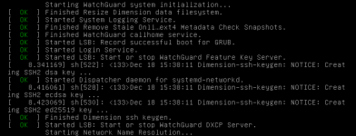

Bon ben a mon avis y'a une cou... dans le potage

ouille ...
a priori,
Note: *.ova, *.ovf files are only compatible with VM exported by VirtualBox v4 and VMWare 5.0 only. *.vmx files are only compatible with VM created by VMware Workstation 8/9/10. *.qvm is for VM created by Virtualization Station.
ptet la version VHD en l'ayant exporté en vmdk
Convert VHD to VMDK in Windows
Run CMD as administrator and go to the directory where qemu-img is installed.
View the virtual disk information:
qemu-img.exe info c:\Virtual\Hyper-V\test-disk.vhd
Convert the VHD disk image to the VMDK format:
qemu-img.exe convert -p c:\Virtual\Hyper-V\test-disk.vhd -O vmdk c:\Virtual\Hyper-V\test-disk.vmdk
aprés tu convertis le .vmdk en .img avec le convertisseur intégré de virtualisaton station
et tu mets le fichier .img comme disque dur de démarrage
